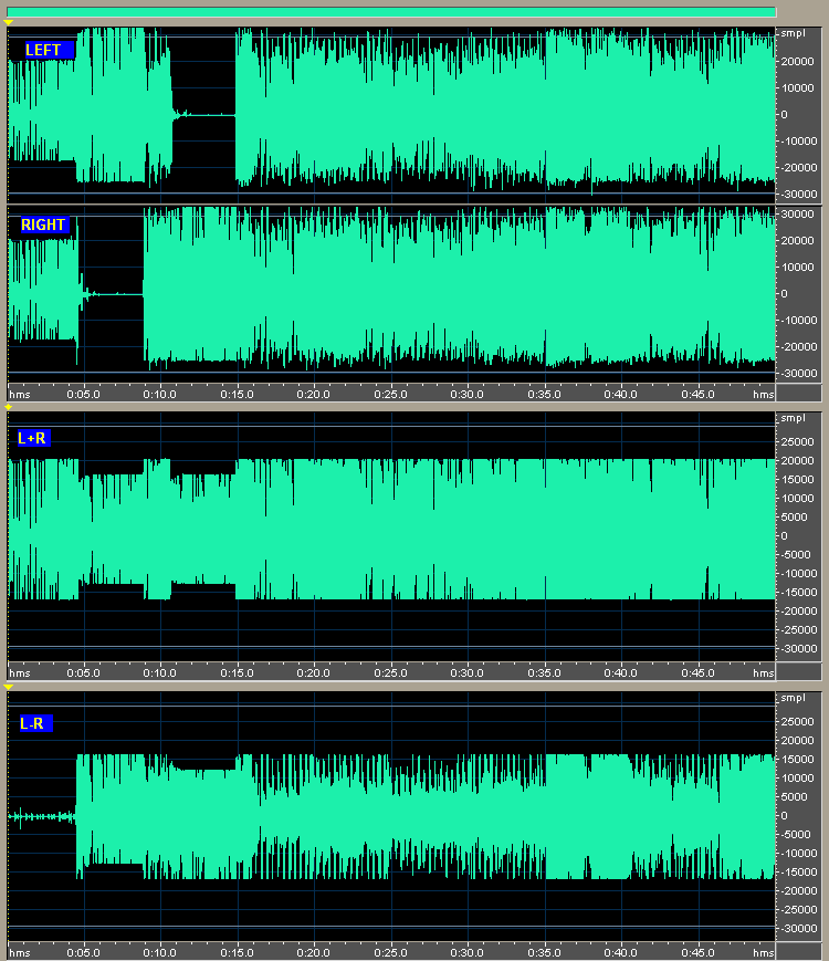

Wooh. Ok, I've implemented it all now - AM L+R and L-R clipping, and limiting of the L and R signals. But, a few things are BAD.
I don't really understand why, but the asymmetrically clipped audio is ok now. Output is good. I still need to add a limiter to really ensure that the signal doesn't surpass -75%, but for now it all looks fine (haven't seen overshoots of more than 3% yet).
I would say this version is good enough for testing... (don't put it on a big transmitter yet, until I've added the 75% limiter).
Will build it & post it tomorrow.
Image is attached which shows Left and Right audio (asymmetrical, bottom clipped around -75%, as you can see there are some bigger overshoots so I really need to add a limiter); L+R audio (100% vs 125% modulation; 100% is 50% in this screenshot), L-R audio (maximum is 100% modulation, 50% in this image). Except for the spikes at the bottom in the top 2 images I think this is perfect.

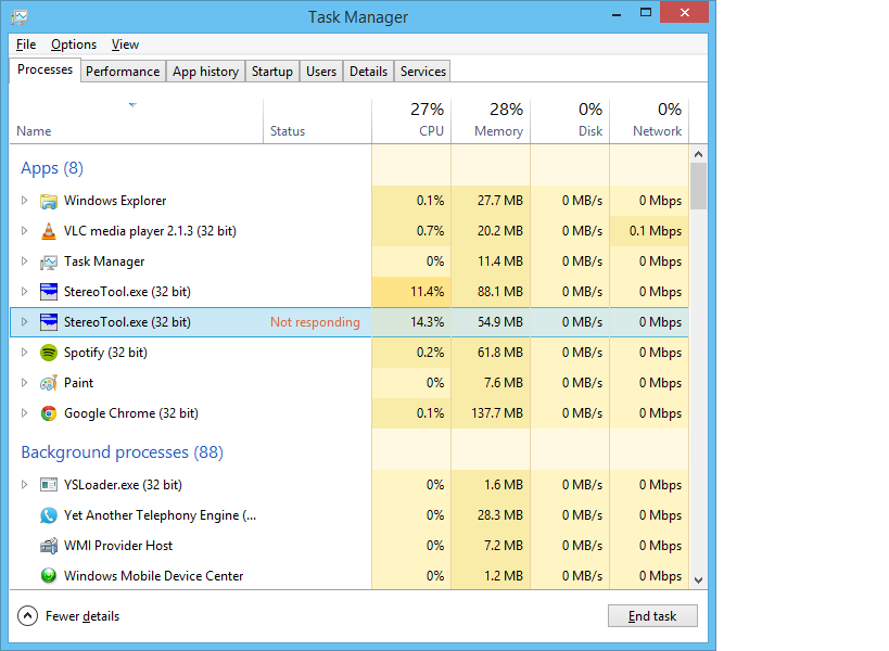

I'll give you some background on the report I filed earlier today. It started when I thought I could hear a difference in the audio listening to a stream with VLC => HiFi Cables => Stereo Tool and using the built in VLC in Stereo Tool. So I opened VLC on my desktop, got the stream playing and tried to do an A/B by switching the inputs in Stereo Tool. It was fine switching from HiFi Cables to internal VLC, but switching back broke Stereo Tool. I wasn't able to restart the audio card. I had to kill it in the task manager and restart, then I was back in business.
I'll do some more testing tomorrow. I'm not calling this a bug, but an interesting finding.
I enjoy Stereo Tool. Keep up the good work!
Just tried it again and this time it did a relaunch. I have restart on crashes checked.
Did you have 'restart on crashes' enabled the first time when this happened, and it didn't restart?
You write you weren't able to restart the audio card - was Stereo Tool hanging completely at that point or did that happen after you pressed the RESTART button? Since you say you had to kill it in Task Manager.
Also I'm a bit confused. The input buffer in your screenshot is shown in blue, which means that normal audio (not from VLC) should have been running. At least it should mean that the sound card was opened succesfully (I think - will check the code). But based on what you write it was dead completely?
And you can reproduce it right? Then I can try adding more info to the exception so I can see *where* it crashes (I have just looked through the code and I don't see any places where I missed handling VLC call exceptions locally - but you still see one so it seems to be coming from somewhere else; I think I need to add function info to the crash info)...
It seems to be nearly impossible or at least difficult to correctly log the actual exception in C++ code (unless I'm going to use OS and compiler specific features, which would mean that it won't work on Linux or Mac etc.).
For now, I'm just going to make sure it logs a more precise location of the crash so I can figure out where it happened (function names instead of thread names). The amount of code under 'AudioRecorder' is pretty small so it should be possible to drill down to the cause in a few iterations...
