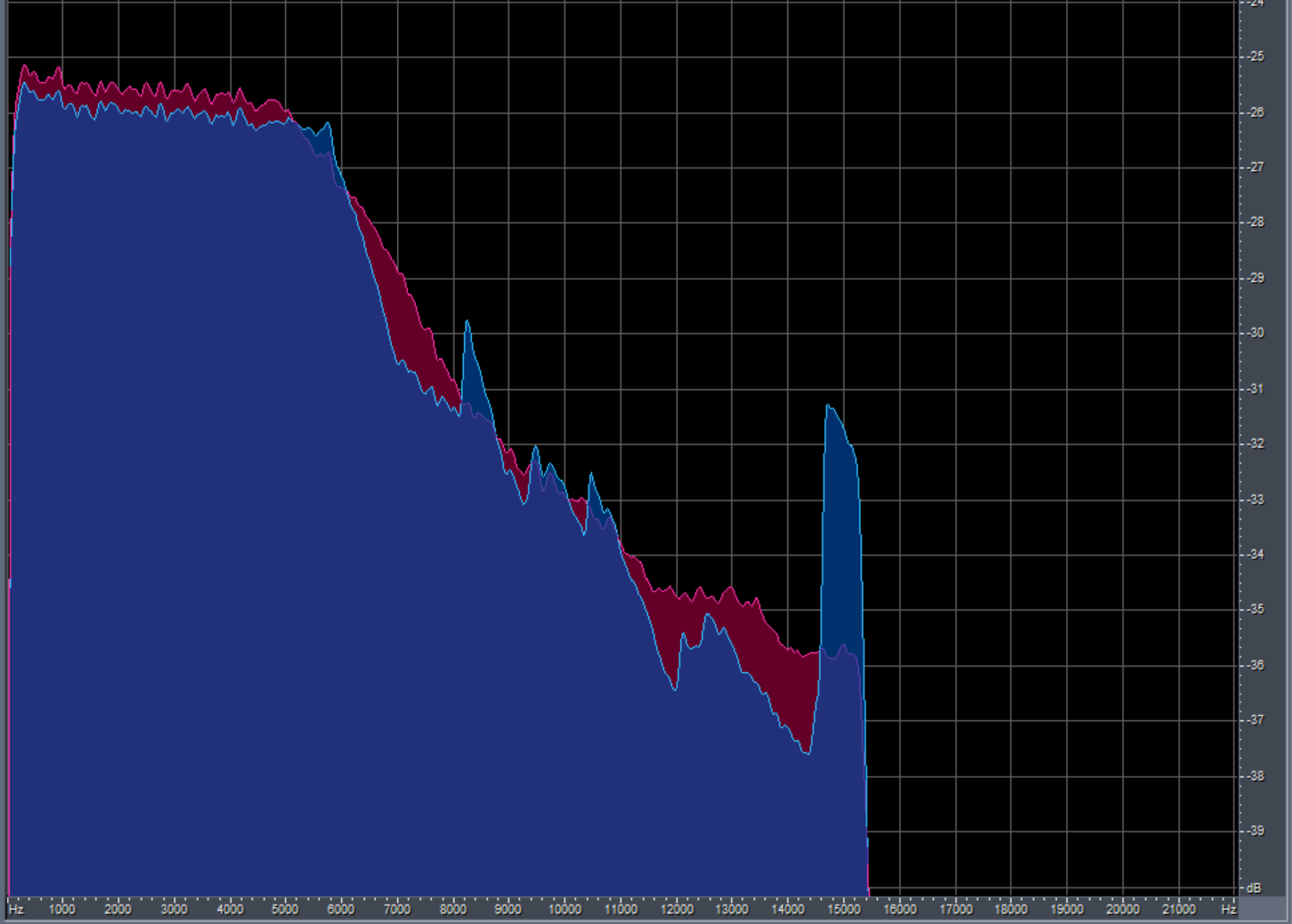

Oops. I had a + and - sign mixed up in a formula. Fixing that improves it quite a bit. Still a bump at 5800 Hz though, and the audio around 16 kHz is still a bit louder than it should be - but far less, and the highs spectrum look smoother now. I know what's causing the remaining high level > 16 kHz, so that's at least an easy fix.
Before and after image, white noise with extreme clipping levels (after de-emphasis). Blue is version 9.63, red is the new 9.64 BETA001.
The swapped + and - caused a sort of sawtooth shape in the spectrum...

Looks way better!
However.. this 5kHz+ is actually directly caused by "Leif's highs gap protection" and it has nothing to do with this new filter fix.
PostPosted: Wed Mar 17, 2021 5:57 pm
Posts: 11488
Looks way better!
Yes, but I've smoothed that out a bit now as well. The initial filter is 2000 Hz wider (1000 in each direction). I'll run a build with this, if more smoothing is needed I think it needs to be done in a different way.

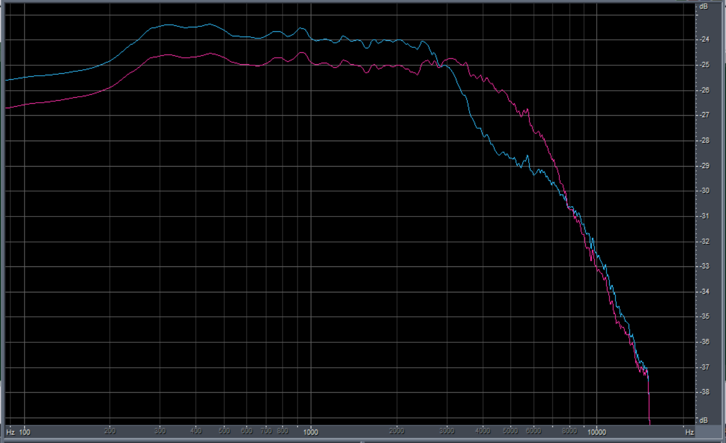

Not only that.. without "Leif's highs gap protection" whole band is much better. Even bass comes back again. That thing inside that filter pushes everything else down.
https://imgur.com/a/a2iyzTy
PostPosted: Wed Mar 17, 2021 6:23 pm
Posts: 11488
Hm, if I turn "Also protect bass" off there's not much difference, and I hear more highs with Leif's Highs Gap Protection enabled, and not much else change in the lows and mids. I think the bass protection must be set to 40 Hz or so, not higher. With higher "Highest vs lowest highs" settings it does start to push things down, but that should be less the case with the new build that's coming now.
Indeed, with the default settings (especially the way too high bass frequency) it does sound worse.
I hope this won't be the case anymore tomorrow (hard to test now because it's all running very slowly, so I can't run it at full speed). At the very least, some tweaking of settings will be needed.
Is your image based on something like white noise?
Even based on the last build, with white noise the non-Leif version looks better. It doesn't touch the lows and mids as much - there is a gap in the mid/highs between 3 and 6 kHz though. So... is the conclusion then that Leif's Gap Protection should just be removed? --> No. I just went back to the original version and that looks fine. Something broke since that version, apparently.
Cyan = without Leif's Gap Protection, purple is with. And in general, purple looks much better.

I think I know what's wrong. The filter frequencies are way off. By adjusting those, it gets closer to the old behavior, with the benefits of the new behavior. More tomorrow... I won't run a build tonight, this needs to be fixed first.
PostPosted: Wed Mar 17, 2021 7:31 pm
Posts: 4249
Between those two.. need to be somewhere in the middle :)
Yes pictures are pink noise into ST, with around 2dB gain reduction acording to Clipper bar (clipper only, abdp off, composite on, rds off) and De-Modulated with MPXTool - 50us.
