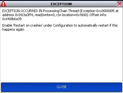

Hmmm ok, tried to load LQ output to feed VAC pipeline 3 to edcast and this baby appeared.
ST is standalone Beta, after this message ST freezes and has to be stopped by taakbeheer.
PostPosted: Thu Jan 11, 2018 10:06 pm
You're using an older beta. This problem was reported and fixed before, please use the latest - 8.55 BETA015 from viewtopic.php?f=14&t=23663&start=80
yup, het is opgelost, thanks :)

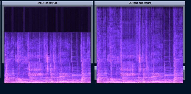

Hi Hans
Version 8.55 BETA021 - Standalone 64 Bit
Windows 10 64Bit, 4K monitor
Cosmetic (does not impact on audio quality)
Processing - Absolute Highs - Input and Output spectrum windows not filling correctly.
Repair - Delossifier - Input and Output spectrum windows not filling correctly.
Rossco
