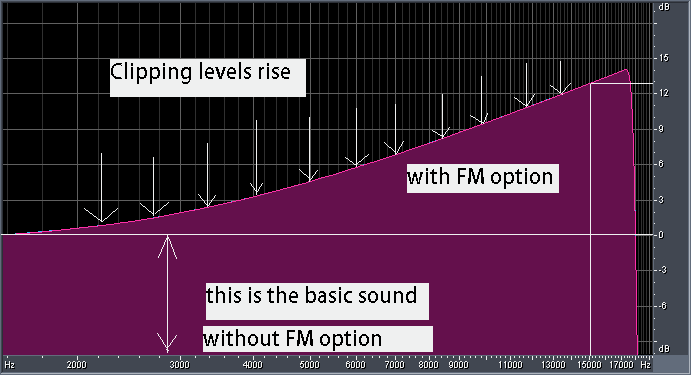

Found Bug in VST betas 79,80
Bass AGC don`t function ( sliders don`t change their settings ) everywhere is 0.000
And Please optimize the code without FM option (only simple sound processing) because if enable this option things are not the same .
With FM sound needs to have separate filters, clippers, limiters etc. and these limit/clipping levels must go up above 0db (if our reference is 0 db) with this curve level/frequency shown below.
All You have to remember is that basic sound must not affect with FM option ( this option is separate processing ) and affect only in receiver because of filters in it :) which causes the de-emphasis.
Or All i want to say is if we adjust the basic sound to 0 db like all settings shared here ..... enabling the FM option must work with 0db+ limit/clipping levels depending on graph curve of pre-emphasis. or hard limit for the FM is at +13 db . In this case drop down bass when high peak of high frequencies is presented will be gone forever . Hope understand me right !!!
If not like this You will not able to send sound to the air and stream at the same time with StereoTool. Levels will be different !
In these days i`ll make a video to show you what I mean.
