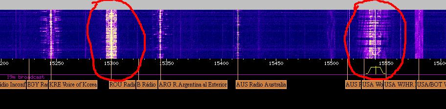

PostPosted: Fri Jun 20, 2014 11:08 pm
for AM limit and clip is a MUST too. it cannot be endless, right ?
Hans , you may ask some radioamateurs that work in the 3.5/7 Mhz band . Their transmitters works in AM LSB mode.
Also you can check in WebSDR.org on some receiver to see that good transmitter have limited signal .Transmitters without limits are taking more "space" on the watefall.
As i understand well , the AM stereo uses DSB ?
See Left is well limited , but on right is not limited .
PostPosted: Sat Jun 21, 2014 12:10 am
Posts: 11481
All you need for that is a good lowpass filter. Except that for AM stereo things are apparently very different, and you'll NEVER get a steep cutoff (the image on the right looks like spectra for AM stereo transmitters as shown in the German PDF file).
