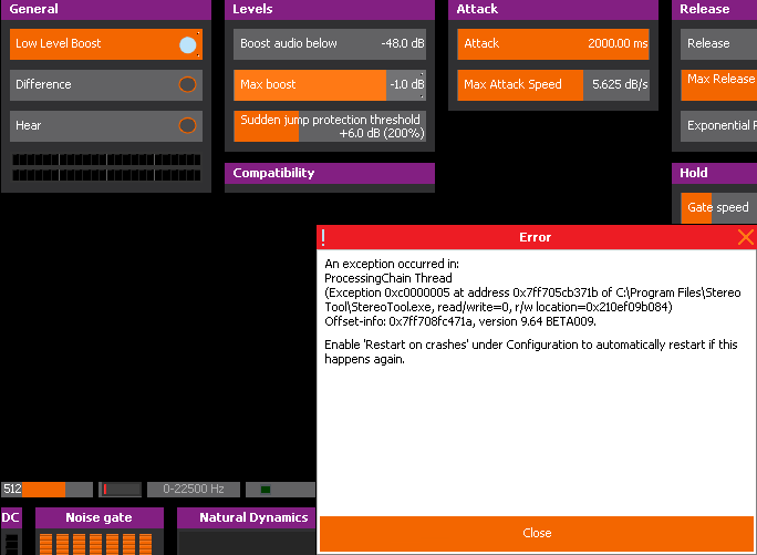

I was playing around with Low Level Boost and I was greeted with this error. The software and low boost filter continued to function.
Sadly, I don't remember what I did before the error other than the conditions: filter off> changed unknown setting> filter on> error.
Stand Alone 964 beta 009 x64, Win10.
