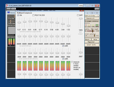

Posts: 22
Hello Hans,
There is a small bug in the vst-version since version 510-09
It opens in a window with a maximum size of the default start window of stereo tool.
If you open for example multiband settings, it is impossible to access to each slider in the same time.
Claude
PostPosted: Sun Sep 19, 2010 11:08 am
Posts: 11456
Claude
It it not possible to enlarge that window?
Actually there was a bug in all the older versions that caused the Stereo Tool window to be 'dead' in at least one VST host. So now I'm telling the Stereo Tool window that it's a child window of the VST application's window. I've done the same thing for all child windows - I guess I should make those a child of my main window instead to fix this.
Edit: I think I've fixed it, building now...
