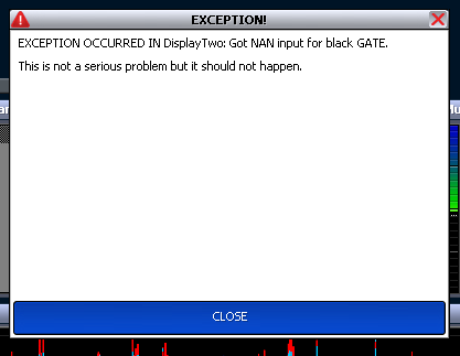

Got this error when switching to my Disco Time preset (got a new version btw). (Winamp DSP)

Am I missing anything?

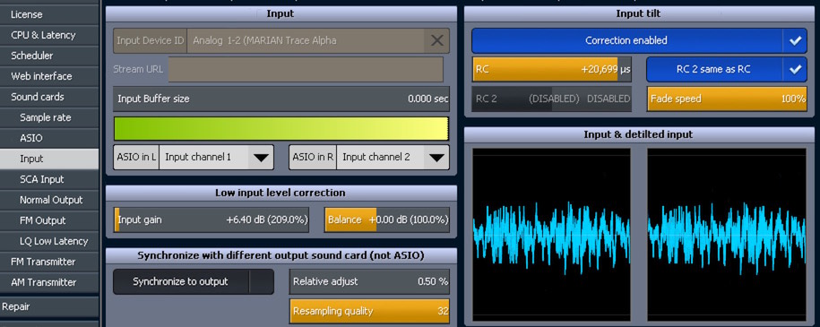

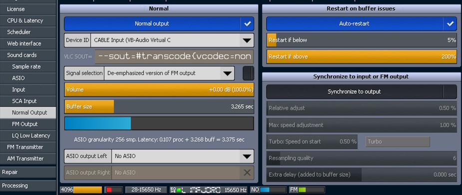

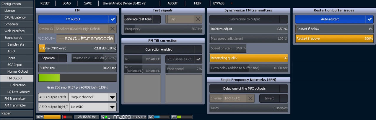

So, question to those who have issues with it: please tell me your exact input and output configuration.
Including the buffer sizes.
This is the settings in 7.73, I didn't change them after installing 7.80 (except from setting Synchronization to OFF as you told me to).
Please let me know if there is more info I can provide to help you troubleshoot!
