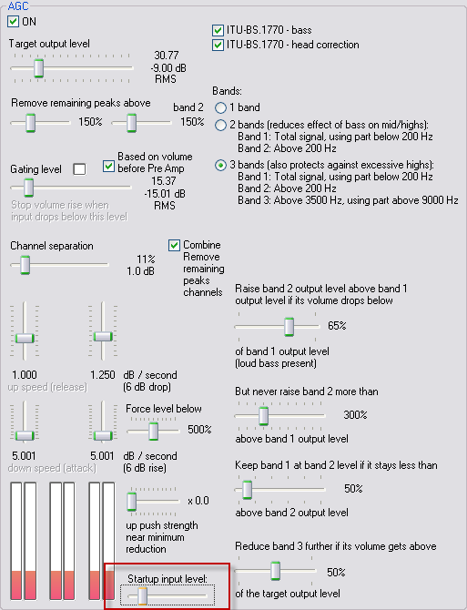

In the AGC, there is a control called "Startup Input Level", which has no associated values ​​and understand that it has no effect to the slide. This control is active, and do they work?
As name said "Startup Input level" - meaning, what level of AGC Attenuation will be at StereoTool startup.
There IS small bug in DSP (if you do not play music) on main ST window AGC is not visible "down" (attenuated), but on AGC window is ok and filter works normaly.
I understand what is the use of control, thanks Bojcha.
What I fail to see at least the DSP is the value of control.

oh yes,
It's not easy to enter some number to this "function" becaue it depends on other settings so Hans left this without value. Anyway it's easy to set it .. when you done with AGC settings, set it and reload ST few times to check where it comes to fit your needs.
hmm.. I just get an idea that maybe it's better add some 'reset' button for this, so you can always see where it'll come on startup.
