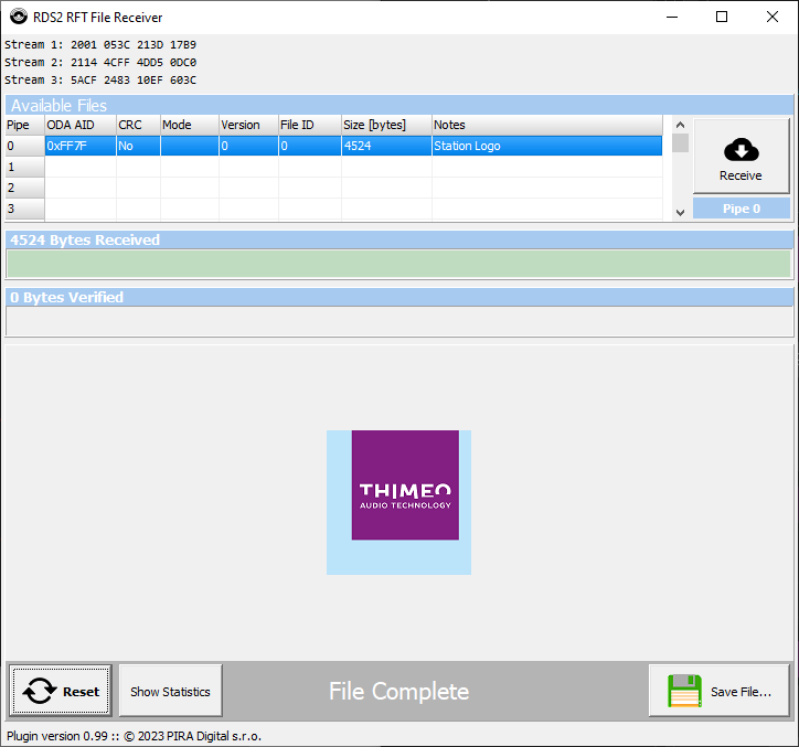

I can confirm that my RDS2 encoder is working correctly. There is now an RFT plugin for RDS Spy so I was able to test my implementation. Just needed to change some code and now it works well.
https://www.1007thecube.com/rds2-rft.png
For testing I ran 3 carriers but switched back to 1 carrier mode and reduced the image size.

I will test that plugin now.
I was just talked with Hans, how guys from PIRA and RDS Spy could support it.
Before anything we need proper receiver.
Anthony, can you send me mpxoutput plugin for sdrsharp? i cant find it.

Tnx, i already found it, but now problem is that i have too much BER in rdsspy.
Exactly same happen when i enable and use MPX output from MPXTool. I tried all i can think of and still too much BER.
However if i directly set MPX Output from StereoTool, no BER all is fine. I dont get it..
edit: fixed it, kinda level was too high from plugin in SDRSharp, but if i set level lower in MpxTool still BER.

Thanks for that link!!!! That was VERY useful! I wanted to look into this after the NAB Show, but Bojcha just mentioned this post to me 2 hours ago and instead of going to bed I just added RDS2 ODA and file transfer. And!!!
I still need to make it use all 3 carriers, determine the timing of ODA description groups etc, but it's 3 AM so I'm going to bed now. I'm going to release version 10.30 first, but this is going to be in the next beta.
