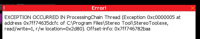

Posts: 118
Hi Hans
Stereo Tool v9.35 Beta008 Stand Alone 64 Bit Windows 10 Pro 2004
Ended up with choppy audio momentarily - error window was clicked away and Stereo Tool returned to normal processing fine.
Still is 90 minutes later.
Regards
Rossco

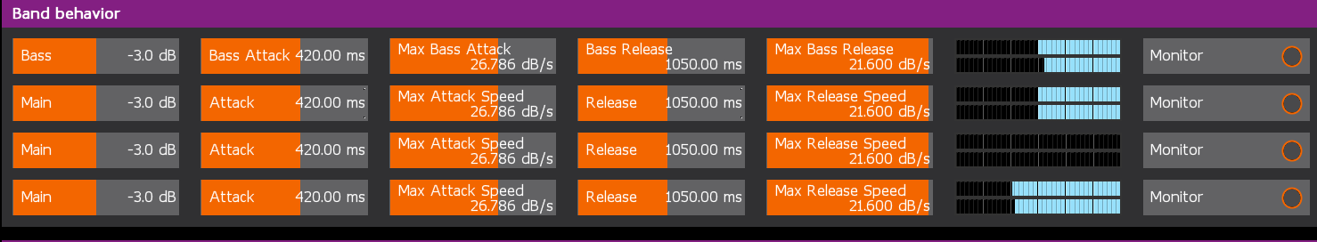

Posts: 93
When setting the AGC to 4 bands, it seems like the display of band 3 is not working. Sound is ok. Using Winamp plugin on Windows 10
*edit* found the problem, when switching in an existing preset from 1 or 2 to 4, the frequency of the new bands is set to 0. ;-)
