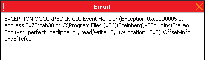

I just ran into this error while trying to adjust the Attenuation with ctrl and shift. Also Shift+adjust doesn't work on the Attenuation like it does in Stereo Tool for the clipper drives and such, either. However, the error doesn't crash the plugin or seem to affect anything once it occurs?
I've been unable to reproduce this, and what's worse, I need to change things in the settings to be able to use the values in the error message, but those changes change those values as well.. so we'll need another build and test for that. Just to make sure, is this the 32 bit or 64 bit VST?
32-bit VST through BreakawayOne's host
edit: btw It's just Ctrl. Not Ctrl+Shift in case that's how it came off.
Just to clarify, this only happens when you use CTRL? Or did it just happen once, in which case the CTRL may or may not have played a role in it?

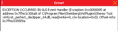

CTRL definitely plays a role. I can manipulate the slider all day and nothing errors; and only once I press CTRL it occurs. And it occurs every time, once, until I restart the host. Is there like a log I can turn on or dig up for more verbose information?
edit: After more testing it also happens in Reaper with the 64 bit version. here is the error:
