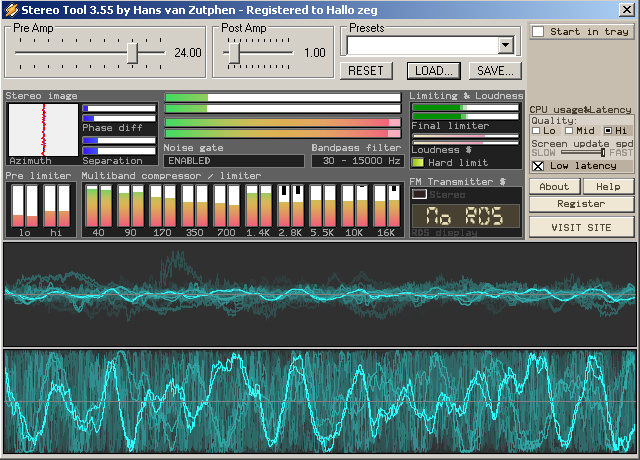

PostPosted: Thu May 07, 2009 7:06 pm
About the font: Does it look different than in this screen shot?
You're right about the presets - I'll fix it asap.
