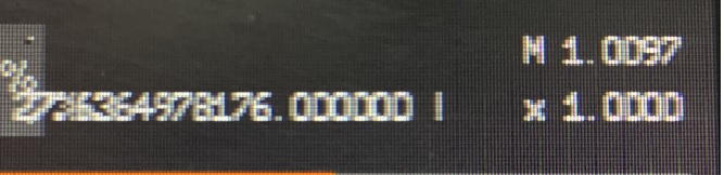

Stereo Tool 9.23 is released!
Hi Hans
Started v9.23 after install and noticed the FM buffer drifting with the figures below.
The buffer (M) ended up running down from 1.0 to 0 - ended up with stuttering on FM, after which it reset and started drifting towards 0 again!
I *think* I have stablised it by setting Relative, Max Dyn, Max Const, Speed on start adjustments all to zero from 0.5% which have been set for ages.
Have you seen this before?
Input, Input 2, Output, LQLL are ASIO, with FM being Non ASIO. Card is set to 192k and ST opens it fine.
Regards
Rossco
 Post subject: Re: Stereo Tool 9.23
PostPosted: Sat Mar 02, 2019 11:12 am
Posts: 11424
Hm, no... it looks like that value on the left (which indicates constant drift over a longer period of time) is somehow completely corrupted. Does this happen directly after starting, or after some time?
PostPosted: Sat Mar 02, 2019 2:28 pm
Posts: 11424
Oi! A value was not initialized, so it just contained some random number. For some reason beyond me, this never showed up before (the bug has been there for at least 6-12 months). And it never showed up in my Valgrind tests either. And you're the only person who mentioned this. Very very odd.
