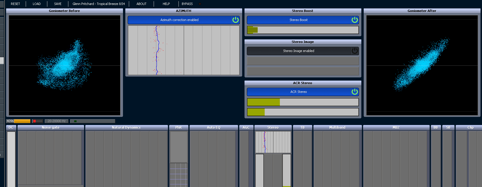

PostPosted: Fri Oct 27, 2017 10:48 am
Screenshot for the next beta...
