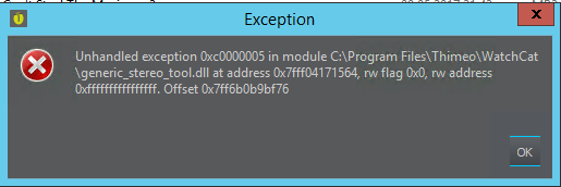

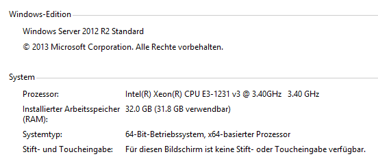

Thisis really a nice tool which would enable us taken cloud based radio automation solutions seriously into consideration. Unfortunately it is still very buggy. Nearly everytime it crashes (see windows error message as well as system information below). The error occurs as soon as new MP3 files have been detected or added manually - no matter if 1 or 100 files. Sometimes (about every 10th try) it works surprisingly. Looks like there are different reasons causing the crashes.
One more thing is missing meta tags in destination files - not a bug but a feature request :-)
Hopefully you get it working stable soon as it opens new possibilities.
PostPosted: Wed May 10, 2017 6:54 am
@Mathijs: This looks like a memory alignment issue (the 0xffffffffffffffff usually indicates that), these can happen on systems that support SSE(x) but don't support AVX. If so, we can usually reproduce it by building a version without AVX support, so I will try that when I get back from Latvia.
