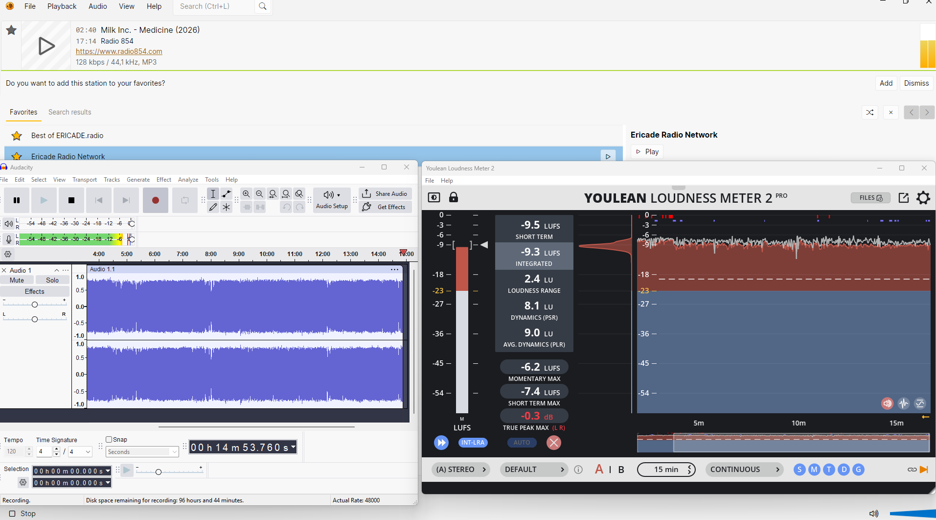

Here are the measurments:
The integrated LUFS is great and so is the LRA. The PLR is good but maybe could get a little bit less contrained (not really necessary). In reality, those values work just fine.
The one thing that you might want to look into is using the (advanced?) clipper to reign in the TPP. Seems like you let through som spikes (transients). Not a big thing.
Summary:
This is a sound shaping you can rely on.
