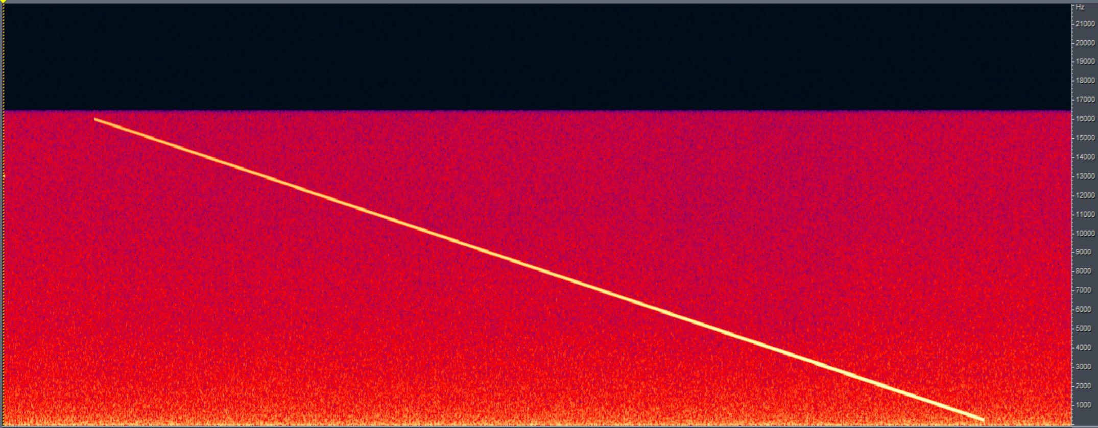

Update: BETA045 adds 3 new things:
  • The "aggressive" highs filter from the previous beta now has a fixed minimum threshold below which it never acts. This may avoid overreactions. Not configurable; it's probably unnoticeable (if the protection does less than before, then I need to fix it).
  • That midhighs protection (500-5000 Hz). It may do too much and damage vocals. I have so far only had time to test it on tones on top of noise; on those it does exactly what we want.
  • Bass protection fix. The mids and highs vs bass IMD protection has 2 "strength" sliders; if they are set high it can happen that the bass disappears completely, and it can even come back with inverted phase. Which would also cause distortion again. There's now a slider that controls the maximum amount of bass that can be removed. Setting it too low may cause IMD distortion
Image below: Spectrum without (top) and with (bottom) this new mids protection. Noise with a sweep. The gap that's seen on top is about 8 dB deeper than at the bottom.

PostPosted: Wed Jun 10, 2026 6:20 pm
Posts: 11519
I have a lot of changes coming up. I think the behavior is much better now.
  • Internally, there was a 'minimum' value below which the aggressive mode would never activate. That seemed to make sense, and it does for pure constant tones. But no longer if the frequency moves around quickly, for example on a high pitch tone in an S sound.
  • Threshold, specifically for highs, has been changed, it used to only look for very narrow spikes in the spectrum (less than 1000 Hz wide), that's now increased to about 6 kHz. Which might be too much. But before it would 'miss' high piched tones on S's that weren't a pure frequency, but just a relatively narrow spike. IT WILL CATCH MUCH MORE NOW at the same setting as before.
I have tested both changes on music and it looks like there's very little effect on normal music.
  • The Aggressive Strength sliders both have been rewritten and work completely differently from before. They seem to be fully active now at 141%; I recommend settings them to that value (but: see below). (Bojcha has already been testing with this and he arrived at 108%, but again: see below)
  • I have added a new "Strength #2" slider. Yes, great name. I think that that slider can replace the existing Strength slider, if you leave that at 141%. My guess is that "#2" works far more naturally. The default setting is 6 dB (which is what it was before as well, there just wasn't a slider for it). If I lower it to 5 dB, and play pink noise with a loud 13 kHz tone, the 13 kHz tone comes out 0.8 dB louder than before, while the noise only drops 0.2 dB. Measured output level (even after demodulation) is also higher if I use this.
With Strength at 141%, Strength #2 at 5 dB, the sweep image from above now looks even better:
