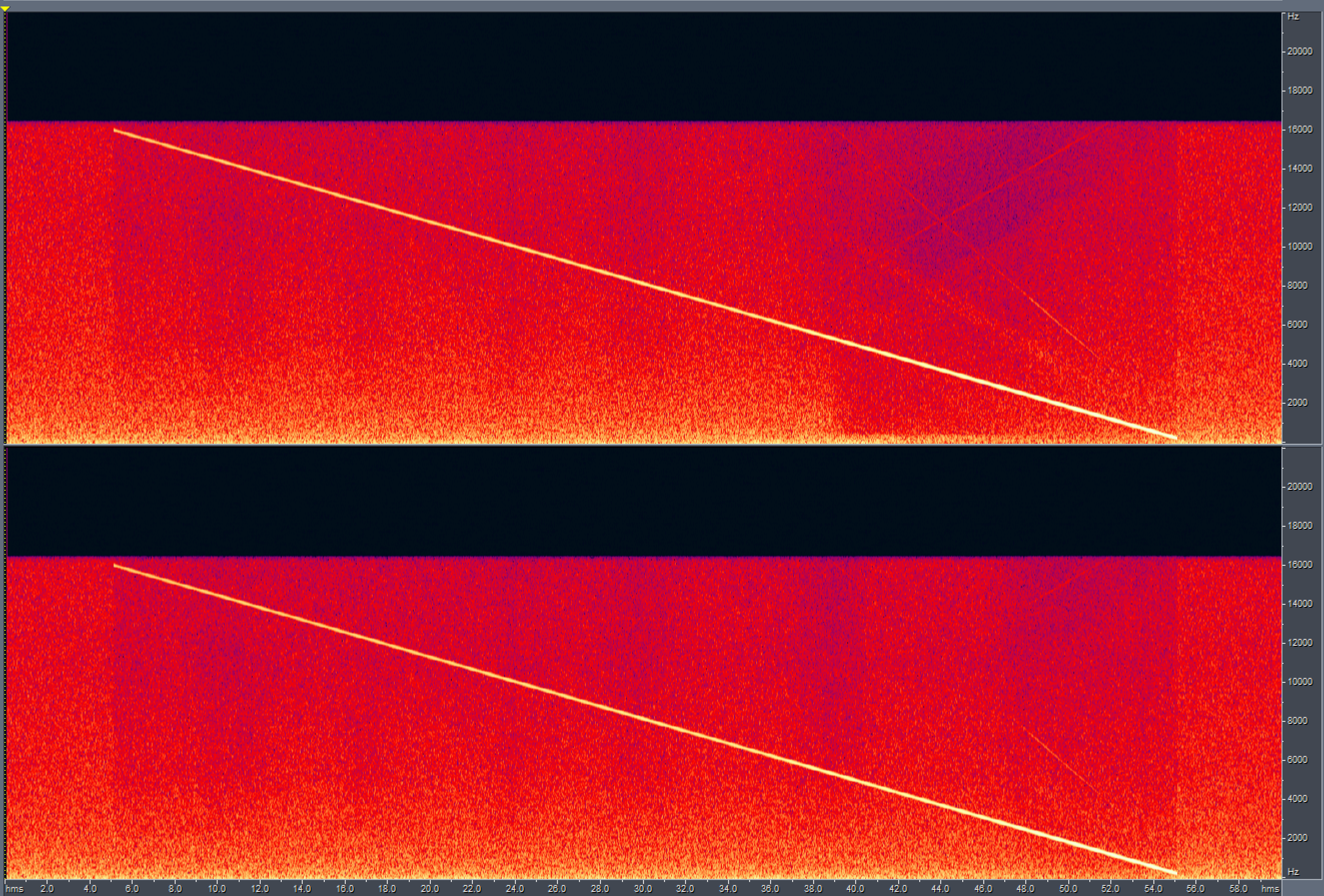

Update: BETA045 adds 3 new things:
  • The "aggressive" highs filter from the previous beta now has a fixed minimum threshold below which it never acts. This may avoid overreactions. Not configurable; it's probably unnoticeable (if the protection does less than before, then I need to fix it).
  • That midhighs protection (500-5000 Hz). It may do too much and damage vocals. I have so far only had time to test it on tones on top of noise; on those it does exactly what we want.
  • Bass protection fix. The mids and highs vs bass IMD protection has 2 "strength" sliders; if they are set high it can happen that the bass disappears completely, and it can even come back with inverted phase. Which would also cause distortion again. There's now a slider that controls the maximum amount of bass that can be removed. Setting it too low may cause IMD distortion
Image below: Spectrum without (top) and with (bottom) this new mids protection. Noise with a sweep. The gap that's seen on top is about 8 dB deeper than at the bottom.
