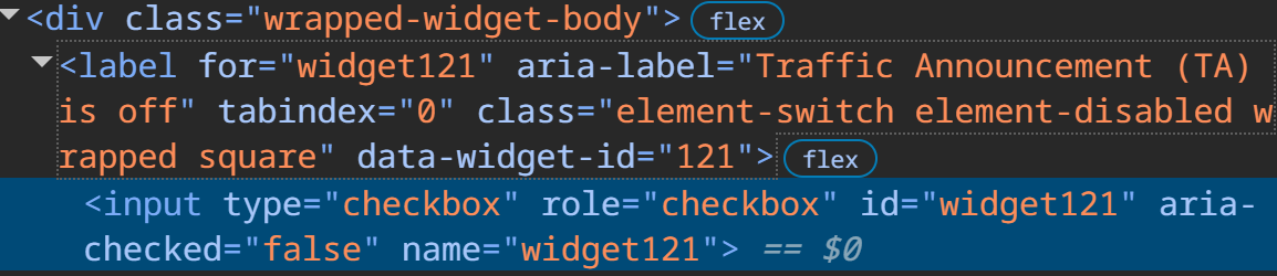

The easiest would be to use the Web UI and "Inspect" the toggle or slider to see the Widget ID number. This number corresponds to the number in the JSON interface for the command you want to use.
