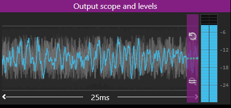

I'll run a build tonight. This is what it looks like with 90 and 0 degrees, both at maximum level (which, again, is a bad idea):

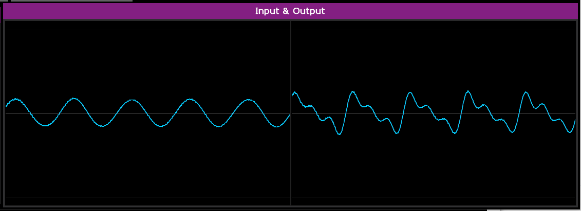

And this is how it was (0 and 0 degrees):
