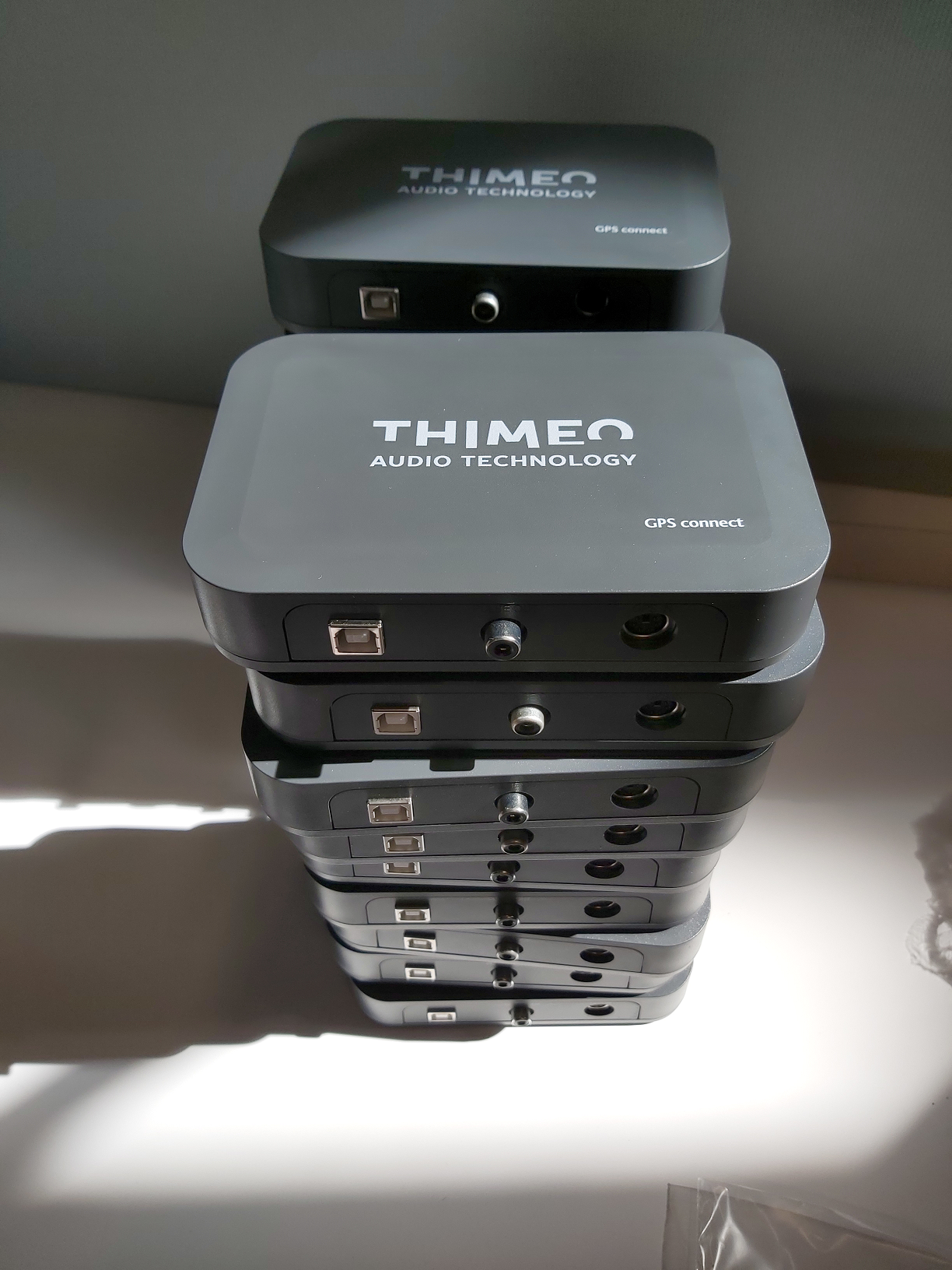

Is there a particular GPS receiver you recommend for uMPX to sync SFN signals? How should it be connected to the PC....serial, USB or some other way? Thanks!

Hi, we have made special boxes that you can use to put in between (it's a pretty complex thing to solder yourself). Just USB isn't enough because the jitter on USB is about 10 ms (0.01 second) and we need pulses with a precision of less a microsecond (0.000001 second).
The first of these boxes are now at several stations where they will be tested. Once we have confirmation that everything works as it should in the field we'll start selling them, and also start selling MicroMPX SFN licenses.
