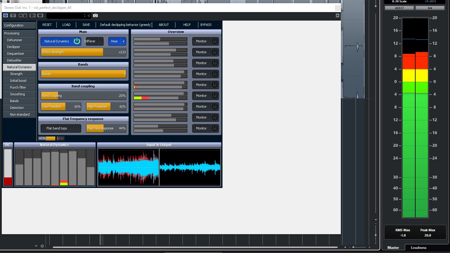

I was updating from the 32 bit version 2 of declipper in Cubase 5 to 64 bit version of Cubase 10 (which no longer can use 32 bit plugins). A big difference I'm noticing in version 3 64 bit from version 2 32 bit is the plugin window is bigger than what declipper actually uses (see below/attachment).
Is that something that might be updated/fixed in a future version or is it like a Cubase issue?

PostPosted: Thu Jan 31, 2019 12:12 am
Posts: 11516
Hm, this is most likely a scaling problem on a 4K screen (do you have a 4K screen?). This appears to be handled differently by every program, I haven't found any solution that works everywhere. If I scale my window as well, in many programs a big part of the display will be cut off - so then this is less bad...
