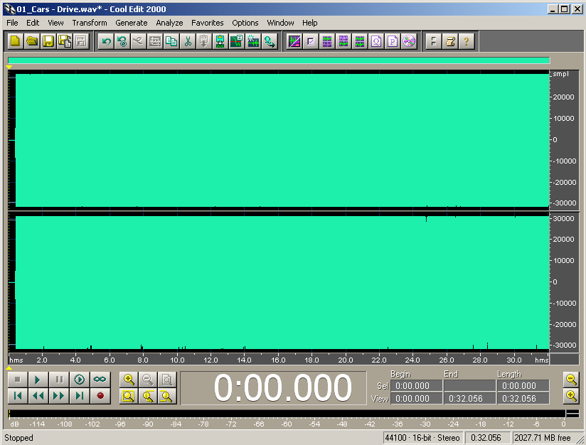

I've been using Stereo Tool for a while for my Internet radio stream (that I use for my and my friends' entertainment mainly), and to control aacPlus CODEC artifacts with stereo image manipulation, and I have a question about "HARD LIMIT". My understanding is that "HARD LIMIT" should flatten all peaks with a fast attack with no discernible overshoot. Unfortunately, I cannot seem to combat this issue -- I am getting substantial overshoot at times.
I have attached a waveform illustrating this.
Here's an example of what I'm looking for in terms of overshoot (look at the blue upper waveforms). This is a sample taken from XM's "The Heat", processed by "Neural Audio".
For comparison purposes, I've aligned the tracks off of the albums themselves (that I transcoded into MP3s) with what XM was playing at that time -- XM's version is shown up top -- my comparison (unprocessed) is shown at the bottom.
I love Stereo Tool, but I cannot seem to get past that one problem! Thanks in advance!

There are several things that can cause overshoots to occur in this setup.
If you feed the output of Stereo Tool through an AAC (or any other lossy) encoder, the wave form changes - and some peaks will get louder. To accomodate for this, lower the Post Amp to slightly below 1 (the Internet Radio presets have the Post Amp set to 0.93 - for lower bitrates, you might need even lower values).
Post Amp is performed AFTER the hard limiter. If you look at the output volume bars in Stereo Tool, if Hard Limit is enabled they should never peak above the level that you set in Post Amp (0.93 means that never more than 93% of the output level bar may be filled).
If the output bar sliders do indeed stay below the threshold, the overshoots are caused after the Stereo Tool processing (eg. probably in the AAC encoder).

I've noticed this prior and post encoding. My output is set to 0.95 -- and I've never seen the output levels exceed a short distance from the end caused by the 0.95.

Overshoot still appears to be there pre-encoder.

Most important question: Do you see overshoots when looking at the output indicators of Stereo Tool? They display the maximum value that Stereo Tool returns to the application - no overshoots in this display means no overshoots in the output signal from Stereo Tool.
Could you post your settings here? Just save to a .sts file, then copy the contents of the file (it's just plain text) in a post here.
Also, which version of Stereo Tool do you use? And in which program do you use it? When looking at the output volume indicators, do they also show overshoots?
I just ran a test with extremely agressive settings, Post Amp at 0.95. When looking at the waveform that came out, I found this:
which looks perfect. Please send me your .sts file so I can run the same test using that file.
By the way - are you using SAM? Because if you are, the built-in SAM AGC might be the cause of the problem. (You should turn it off)

I am using SAM. The built-in AGC should be off. The overshoots aren't a huge issue, but I do see them.
I am using version 3.14. The output volume indicators do not show overshoots. I almost wonder if it is how I am capturing the waveform...
Thank you!

I've tried your settings here in Winamp, and I'm not getting any overshoots.
Which of course leads to the question: How did you measure your output?
In SAM, make sure that AGC is turned off for ALL processing channels, as described in http://help.stereotool.com/stereo_tool_and_sam3.shtml - make sure that they are ALL set to Bypass.
