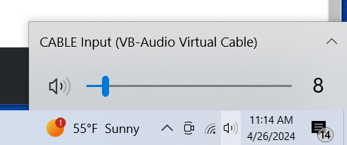

and this is what I am seeing in Windows icon at bottom of screen which moving the volume slider does not adjust the volume, what am I doing wrong please?

The volume can be controlled via Stereo Tool with the slider under HD Output. VB cable doesn't work with window's volume controls, unfortunately.
I have an AutoHotkey script that maps the system volume to stereo tool's volume though.

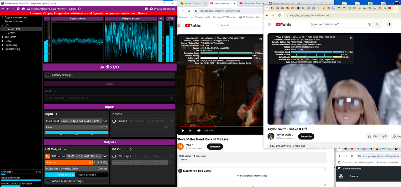

Ok guys, I can do my testing now. Testing now with these 2 tunes and that taylor swift tune seems to be consistent with most videos on my end. I have adjusted the Buffer to 104 and using the Adaptive Bass Monster. No matter which preset I load there is first a major problem with the audio not being in sync with the video, what can i do here to correct that and also to get the Steve Miller song to match the volume of the Taylor song please?

There's still an obvious delay when set to 104? That's about 6 frames difference at 60 fps. If you can make it lower and keep the buffer bar % stable, it would reduce the delay. You can try holding SHIFT to make the slider move more per mouse wheel notch, and CTRL to make it move less, or you can right-click and type a value (in case you have trouble dialing in a buffer/delay with the slider).
Make sure the videos coming into Stereo Tool are maxed out in volume, also enable the declipper (in the Repair section) to reduce some of the distortions in the Steve Miller band video. If you can't find a preset that keeps the audio mostly consistent, keep trying. Try some of Bojcha's presets, too. That video is an exception to most videos on YouTube.
You can also try playing with the Quick-Adjust sliders on the home/processing page. Raising the density essentially makes the compressors work harder.
edit: Try the Adaptive Bass Monster DENSE version, not the OPEN version to get more aggressive processing. The Open one doesn't keep the levels as consistent as you want.
edit2: Also it's to be noted that the Adaptive presets use the Advanced Dynamics license, which is not part of Basic Stereo Tool. To disable this and any other unregistered aspect, click the big red banner at the top and it'll take you to a button to Turn All Unlicensed Features Off. This will help you understand more how it's going to sound with a Basic license. You'll still likely need to reenable the Advanced Clipper (Processing, Limiting and Clipping, Advanced Clipper) to keep the output clean.

I am trying Hello Nine. Have dropped the buffer size to 70ms. Still same delay.
I think you are correct on this particular video is not the norm so might be best to remove/replace this and all videos with similar issues from my playlist? No matter what I do I still see the Input meter maxed out and red on this video and it's not only it's volume, the overall instruments are louder than other videos because when I drop that video's volume to match another track and run both at the same time this video still covers the other one.
Try using WASAPI on your Input/Output instead of Kernal Streaming or MME. WASAPI can handle lower latencies. However, if you have an ASIO-capable hardware device, that would be capable of the lowest latency.
It should be noted that Loudness is different from Peak value. LUFS-i (Loudness Units full-scale Integrated) is the normalization unit of measurement. This article should cover it. https://www.sweetwater.com/insync/what- ... ld-i-care/
