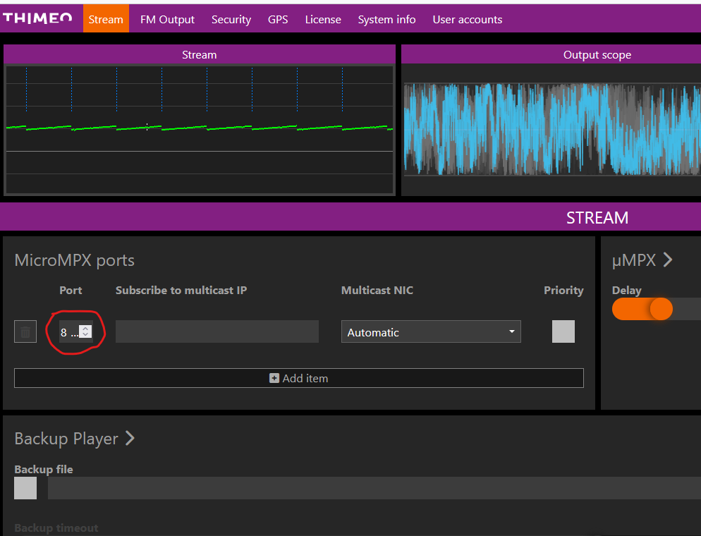

  • Renamed "MicroMPX ports" to "MicroMPX inputs" in MicroMPX decoder

  • Web interface: Fixed alignment issue in MicroMPX builds

  • Web interface: MicroMPX decoder display "ports" field gets too small after switching to another tab and then back, with a relatively small window. https://forums.stereotool.com/download/file.php?id=5827

  • GUI/Web: Rewrite of wave display code, should work better than before, and skinning for declipper-veil displays works.
