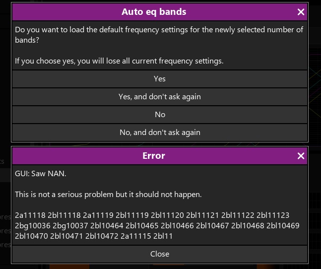

PostPosted: Sun Feb 05, 2023 12:03 am
Posts: 1164
Hm,
I think it`s an error, but i don`t know.
I was selecting 9 bands instead of 5 in AutoEQ ... and this happens.
Operation cannot continue. Must close and reopen. Reopened was with 9 bands in operation.
PostPosted: Mon Feb 06, 2023 2:01 pm
Posts: 833
Yeah this happens in Bass EQ as well.
Bass EQ also seems to make MB1 flip out and go nuts when adjusting the channel linking in Bass EQ. Should I send my ini and instructions to replicate?
PostPosted: Mon Feb 06, 2023 2:56 pm
Posts: 11221
Hi, yes, please send me a file + how to reproduce it. It doesn't appear to happen here. I tried changing the number of bands and playing with channel linking.
