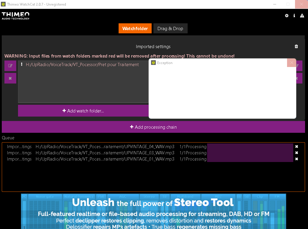

I have also problems with ThimeoWatchCat_64_installer_BETA1002-0437 or 044
He don't process files and close or display this empty Execption windows
No problem with Stable realease.

I have found a bug that caused an exception. It looks like it broke quite a while ago (BETA028 was already broken, version 10.00 was ok). I'm going to continue testing to see if this is the only issue. It did break due to I/O rewrites.
Edit: At least on my system, it's working again in debug mode (release mode already worked, but for exceptions in release mode you never really know when they pop up or when they are ignored. I'll run a new build tonight, I hope that this will fix the issue.
Version 2.0.7 is the WatchCat version. But I guess you mean, make the version number identical to that of Stereo Tool? We also release them together so that would actually make a lot more sense...

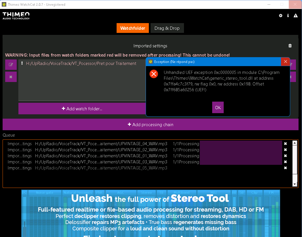

Hanz, version ThimeoWatchCat_64_installer_BETA1002-045 is still not working
after processing 3 files, he crash
Is it possible to display build number to know wich version is used ?
