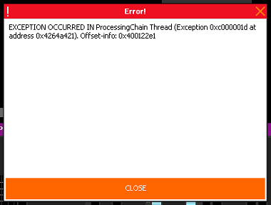

PostPosted: Tue Dec 18, 2018 9:54 pm
Posts: 248
Got this error:
Running on Intel Core 2 Duo E8600 Win10 Enterprise x64
This is the DSP version Beta 18:
-also: Deleted the .ini file as well and am running default Stargate Preset.

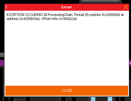

This one still comes up as Beta 18. With this slightly different error:
PostPosted: Wed Dec 19, 2018 2:27 pm
Posts: 11520
This one comes up as Beta 18. With this slightly different error:
Ow. I was afraid that this would happen (but didn't really expect it).
Please answer a few questions:
1. Which OS are you using?
2. What *exact* CPU is in it?
3. Is the GUI still usable? If so, please go to Configuration, set it to "Extreme Tweaker" mode, and check (bottom right) what it says under "CPU features".
It might (should) help to change that to a lower setting.
Edit: Never mind. Am seeing it here too on an old XP install. Searching for the cause now....
PostPosted: Wed Dec 19, 2018 3:09 pm
Posts: 248
Hans,
I can't clear the error. It keeps repeating.
Thanks,
PostPosted: Wed Dec 19, 2018 3:35 pm
Posts: 11520
Hans,
Thanks,
Yes. It appears that the compiler has done things that I didn't expect. Am trying to figure out now how to avoid that from happening. Debug version is ok, release is not, on older systems/OS's...
Edit: Been googling and there doesn't appear to be a good (reliable) solution for this issue. It's a real fringe case of compiler optimization (mis)behavior. Ugh. Will try out some things later today.
PostPosted: Wed Dec 19, 2018 4:45 pm
