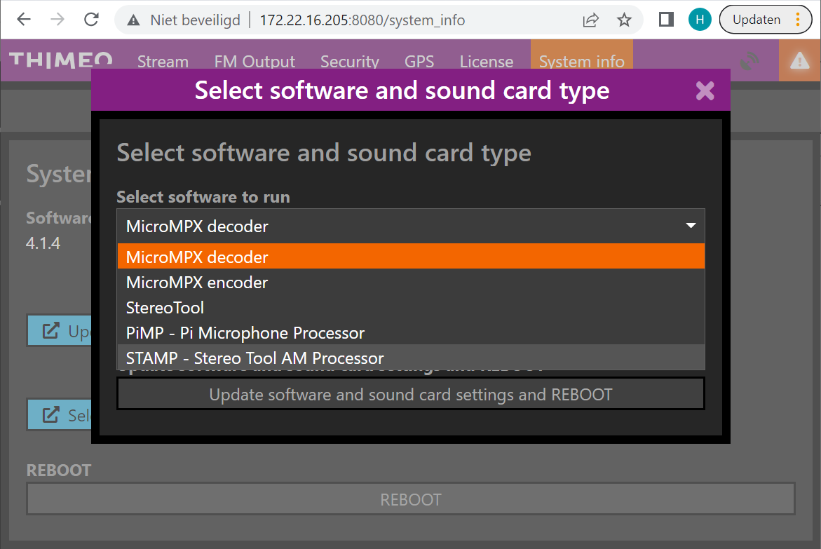

New IMAGE file with BETA055 installed, including PiMP with 4.2 ms latency! (Pi 4 only)
https://www.stereotool.com/download/Thimeo_Pi34.zip
This image starts up with MicroMPX, you can switch to another product such as PiMP via System Info:
Please note: There are changes in the image file, you cannot use the previous image file with the new installers (well you can, but you'll get audio hiccups in PiMP).
