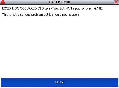

Yup, need more info! Does it happen while just playing audio, or were you changing settings? If it happened while just playing audio I need your settings so I can try to reproduce it. So, did you get silence? Can you reproduce it? If so, can you try turning filters off (from end to start) to see where it originates from?
And how to reproduce it ?
Tell us ( and to Hans in first place) , what did you do , and may be some steps , so we can try to reproduce it.
Sorry but I had to go really fast and now i am back and ready to give explanations...
While adjusting the ND first - Second and third band frequencies I got an NAN output (but it runs again and again because the exception window won't close if I press close). The exception window says "EXCEPTION OCCURRED IN DisplayTwo : Got an NAN input for black GATE".
After that point both multi-bands are stuck at 0dB gain reduction. This causes the audio after the pre-amp gain to go directly to the clipper.
EDIT 1 : It happened again but this time the GUI just froze and then set the frequencies to random values .
My radio station
http://amradio.ddns.net
 Post subject: Re: Stereo Tool 7.72
PostPosted: Wed Aug 19, 2015 7:08 am
Confirm it !! From default frequencies in ND , i start to move band 2 and then band 3 ... voila !
See picture . And yes, something is happen with the MB . Clipper gets crazy and starts to clipping very hard :)
Edit: Strange , after second time of repeating this , NAN stop to appear. Will keep trying to make same steps to see.
Ok, i got again this window and error , when keep moving the frequency bands . I start to move next bands ( 4, 5....) and again pop up!

Ok. The good news here is that it only happens when you're adjusting settings (pfew!!!) so it's not so urgent that I need to upload a fix today - there will be someone there when it happens.
And that it's reproducable. That always helps :)
I will put it on the todo list for the next version.
