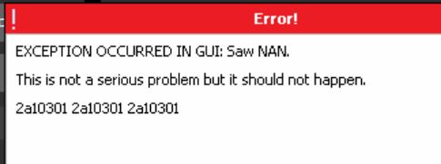

PostPosted: Thu Dec 27, 2018 2:42 pm
Posts: 118
Stereo Tool 9.12 BETA023
Windows 64 bit stand alone
Window 10 64 bit
I am seeing the following error when I run any of the 9.12 BETAs, connect in with Teamviewer 14 then disconnect.
It stops the audio processing then will restart immediately after I reconnect to the machine.
Anyone else seeing this?
Teamviewer 14 is running current build on both machines...
Rossco
PostPosted: Thu Dec 27, 2018 6:02 pm
Posts: 11520
Window 10 64 bit
Rossco
This would appear to indicate that TeamViewer 14 is interfering with the sound card input. Just for clarity, am I understanding correctly that you connect and the audio drops out, then you disconnect (audio is still gone) and reconnect and at that point the audio is back???
O, and is this new in the 9.12 beta's, or is this behavior also there in older versions? I would expect so...
