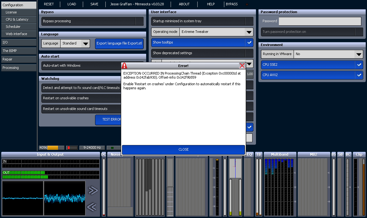

PostPosted: Sat Dec 22, 2018 6:45 pm
The AVX2 button/config probably shouldn't be clickable/"usable" for my CPU...
https://ark.intel.com/products/41315/In ... -2-93-GHz-

I'm seeing some differences between these versions that I can't explain in Stokkemask. Are you using that? The rest appears to be more or less the same. The compiler might make some different optimization decisions, they can lead to wildly different waveforms but that shouldn't affect the sound...
Your pc should be using the AVX2 path in all these versions. You can try turning AVX2 off in the GUI (set it to Extreme Tweaker mode, then there's a setting in the Configuration panel). But I don't think it's that, since it should have taken the AVX path every time.
Ow, and before BETA018, it would have always taken the SSE2 path because the AVX2 path wasn't available.

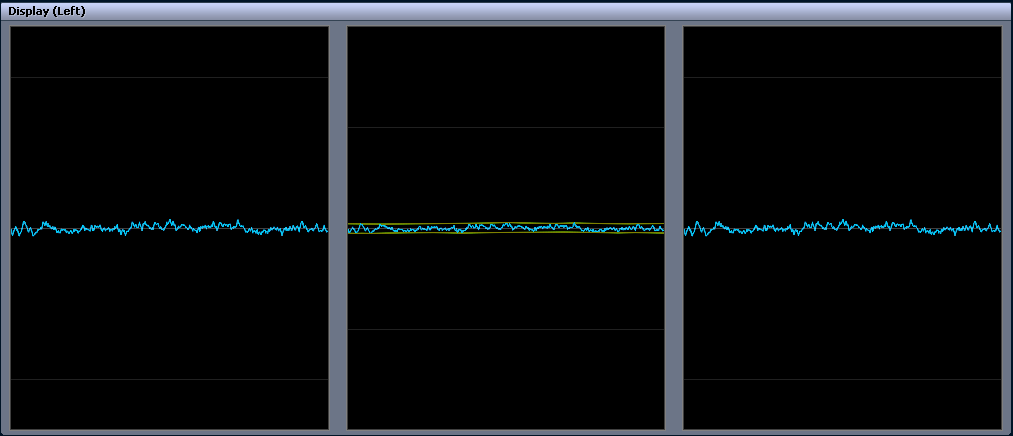

Veil scope's scale is wrong in the Declipper Display pages.

Display level is relative to the input level, with 6 dB headroom. So if the input level is really low it will look like this.
