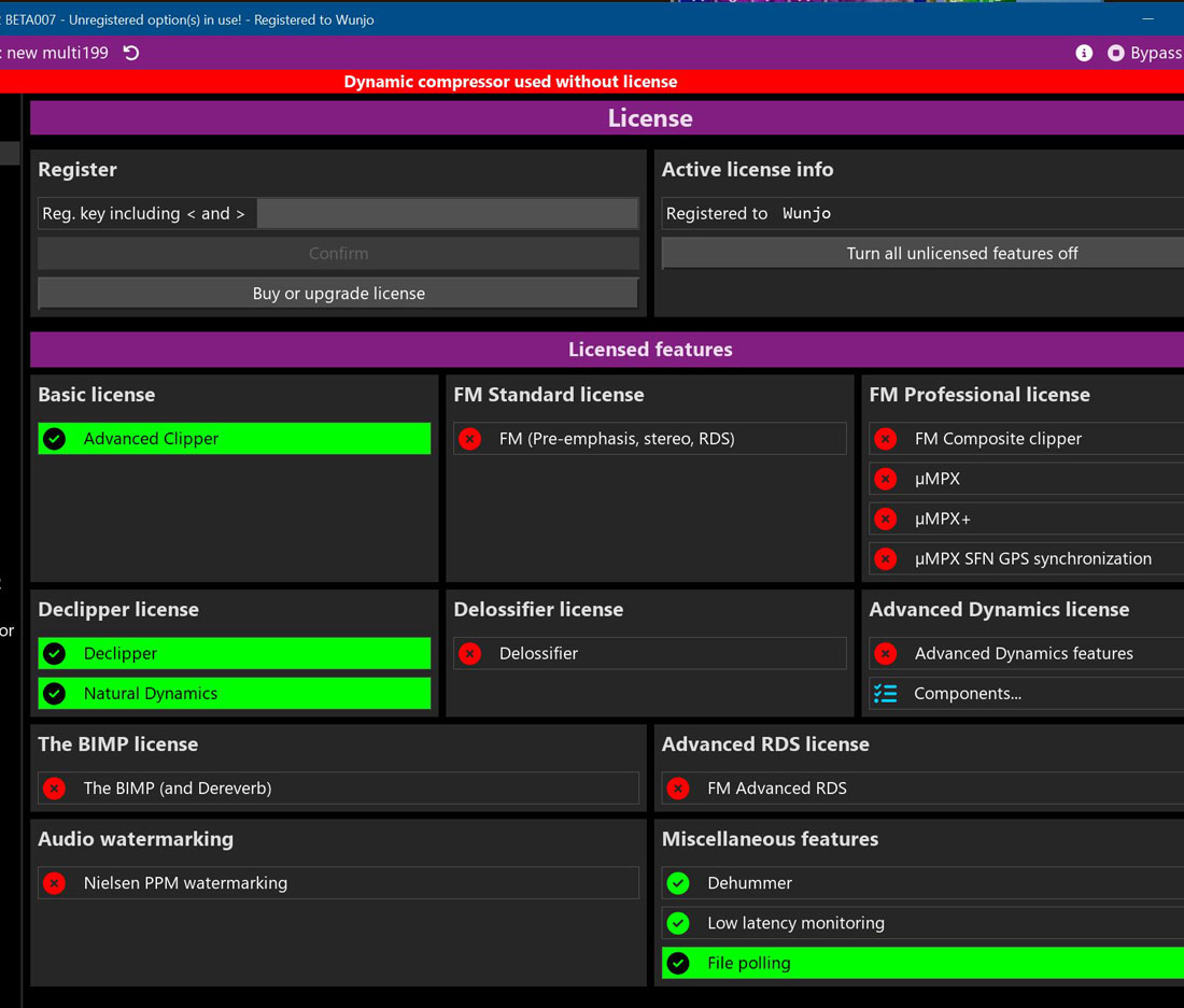

Hans, there is something I don't understand about licensing.
There is a red banner about an unregistered license, however I can't find witch setting it caused.
Pushing the button "Turn all unlicensed features of" doesn't make any change.
PostPosted: Mon Feb 05, 2024 12:13 am
Posts: 840
I'm not certain if this is the cause or if this will fix it, but can you try something for me? I think the new Adaptive mode in the compressors may be on, and it's possible this hasn't been integrated into the Turn Off All Unlicensed Features button.
To turn this mode off, you'll want to look for Miscellaneous > Compressor type and change it to Analog in the AGC and/or Compressors. Again, this is just a hunch. I'll do some testing and see if I can't get something similar to appear here.
edit: Ah yes. The button to turn off unlicensed features doesn't work on the Adaptive selection on multiband1 after I disable everything with the button, then manually reenable it.
Thanks,
It indeed disappeared after turning all adaptive modes off :-) There is no license yet to avoid this.

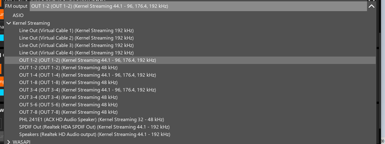

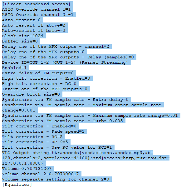

Hi everyone.
I have a problem selecting the FM output.
When I start stereotools it selects the wrong output.
I use the Behringer UMC404HD sound card for the FM output but I also have the Behringer x32 compact mixer with the USB connection therefore in the list of sound cards 2 outputs appear with the same name but with different sampling frequencies. Stereotools chooses the wrong card. Once reset stereotools works correctly until the next reboot where the problem returns.
